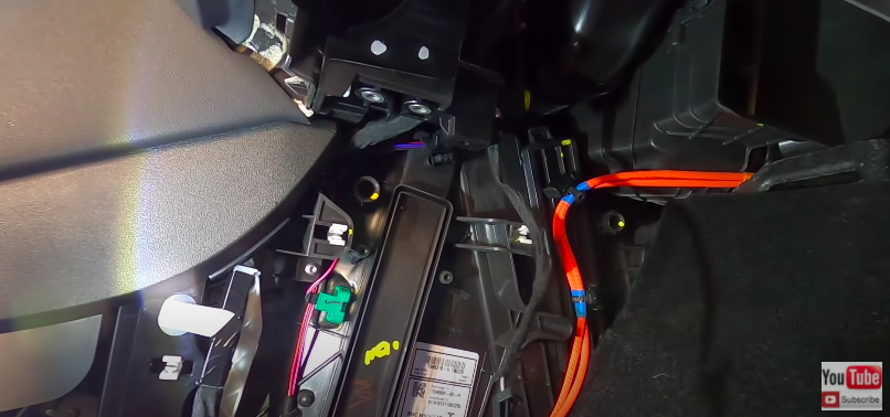

…..apart from the higher voltage traction pack that powers the motor, connected electronics and heater element all the other electrical components are 12v.
I will include an image of the orange high voltage cables that feed the heater element in a Tesla model 3 - It will be something very similar in the ZS EV.
As @Alansurfer correctly points out, the heater blow motor ( fan ) is powered by the 12 volt battery.
