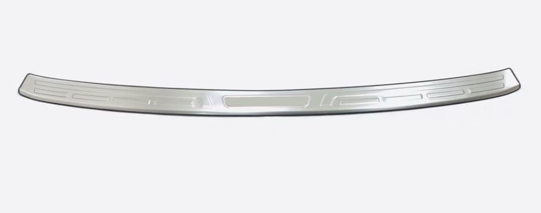

Where can you get these from?
Somewhere like this colours in stock black\gloss black\silver\carbon fibre
Or eBay Amazon AliExpress or some dealers also do them
