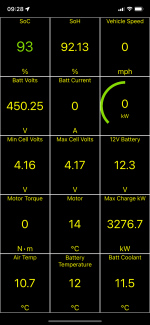

Hi all. I have just bought a second hand ZS EV Gen 1 with 20K miles. The car is awesome, but I have a couple of questions regarding the battery SOH and range in such a low mileage car.
My OBD scanner shows the SOH is 92.13% - is this to be expected at this age and mileage?
The battery balanced last night on the 2.3kW charger. This morning the scanner shows 93% SOC (even though it charged fully and stopped charging itself) and 151 miles range (after resetting both trips. The battery voltage is 450V. Does this sound normal?
Pictures attached for info.
That's about the expected. The battery always deteriorates more at the start, then slows down.
The latest firmware has nearly all the buffer at the top, so 100% displayed SoC is 93.2% real SoC, and 0% displayed is about 0.5% real SoC. Your scanner is showing you real SoC. So this is completely expected; no need to fiddle with discharging and recharging.
The latest firmware aims for 449 V. My Mark 1 ends up at about 452 V; I have no idea why it "misses" its target like that. Again, totally normal.
Thanks that’s pretty much what I was hoping and all makes perfect sense.
