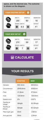

Below would suggest there is but with a surprising conclusion:
You could be on to something though, what if 16” stock tyre models are more economical than what MG puts on 17” wheels?

Just one flaw, according to post 15, the circumference of a 17” tyre is actually slightly smaller than a 16”, thus the wheels need to spin faster which in turn should make the motor more efficient if I understand the graph correctly?
Yes you are correct. Consider my wrists slapped. Confusingly I did find that larger 17 tyre wheel combinations have been fitted to the MG5 but not sure if that was for petrol versions.
