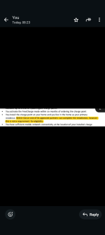

I also found this in their terms and conditions so I guess I've answered my own question
FreeCharge is only available though BGas authorised installers. And your mate should NOT be installing any charger without the required qualifications, and issues and his/your household insurance could be drawn into question !
