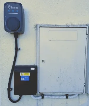

My bold ... the box with the MCB is outside? Hmm ....
As you can see, apart from the major regs change 20 years ago, which outlawed any external or wet room diy work, the technical needs of this equipment vastly outskill the capabilities of any hobby installer anyway.
Adding a properly certified charger is clearly a bonus when selling or renting out a property. I wouldn’t be EVing without one for sure.
This is my EVSE installation obtained through Octopus Energy. I went for untethered because I needed 10m of cable.
