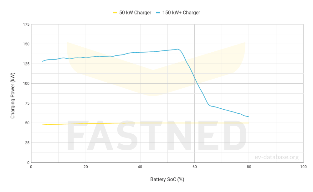

i.e. the LR charges at up to 142kW, which is "Rapid". And 142kW @ 400V correlates to a current of approx. 350A.
