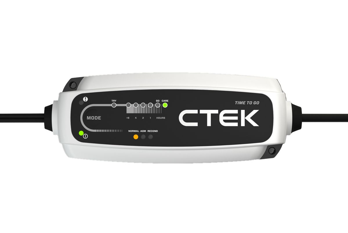

John - Charging slowly and more gradually from external 12volt battery charger overnight, is likely the best option to help recover your now depleted ( newish ) battery.
This is assuming you already have one of the newer smart chargers at your disposal of course.
When the smart charger is first connected and turned on, it will initially interrogate the current condition of the battery.
Then it will automatically set up program schedule length / rate and time best suited to the present status / condition ( SOH - State Of Health ) of your 12 volt battery.
It will then commence the charge cycle very slowly at first and then it will ramp up the charge rate progressively, then returning to a lower rate before finally finishing the charging cycle.

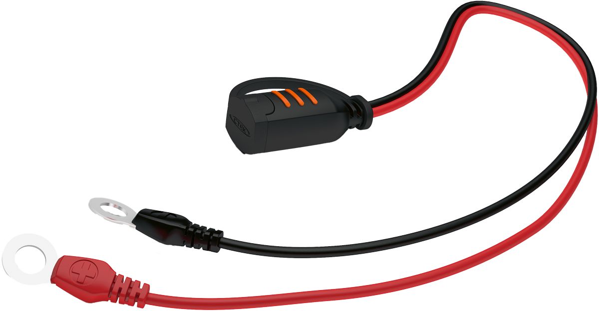

I have the CTEK smart charger that you able to purchase the optional quick connect loom.
This short loom is very easy connected to the main battery terminals all of the time.
It has a fool proof quick release connector that you then use to quickly attach your smart charger.
A better option than using the crocodile clamps they give you.
This maybe ideal option for you, if you want to put your battery on charge on a fairly regular basis, given your low usage case.
The SMART unit is small and can be left protected from the elements under the bonnet.

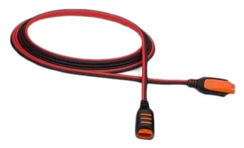

Here is a link to the CTEK GO unit and the quick connect lead that I have, plus the quick connect extension lead, but shop around for best prices !.
Good luck with your continued recovery John ! (y).
