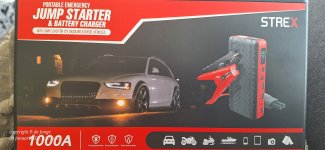

Thank you very much for your reply. I have been reading around and was not aware the 12V battery is the power house, as I have never had any issues. Very naive, but I will learn from this. I will pop to Halfords and see if I can get a suitable booster as I need the car later!
The car needs the 12V battery to turn on the computer that then kicks the HV battery into life and that charges the 12V battery. You only need a booster pack connected to the 12V battery to get the car back on in Ready mode.
Thank you very much for your reply. I have been reading around and was not aware the 12v battery is the power house, as I have never had any issues. Very naive, but I will learn from this. I will pop to Halfords and see if I can get a suitable booster as I need the car later!
You don't need a powerful one as you aren't turning an engine over just powering up a few relays etc.

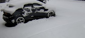

Anyone know the CCA figure for the standard MG4 12V battery ?
I know someone who has a 12V car battery tester and I think it needs this figure entering to estimate the battery % SoH. Thought I'd give mine a check after reading this and after the freezing weather 🥶
Note : I am just talking about the 12V battery under the bonnet ! 👍
Sounds like a good idea after my experience. I got a battery booster to charge the battery up and waited……..I ended up getting the AA out in the end and the battery was reading at 4V! It was boosted quickly back to 14.1V and then I took the car for a run, as suggested by AA, and went to MG about 12 miles away to make sure the battery was charging and keeping the charge.
Due to the snow, hail and ice, I managed to also damage my windscreen wipers along the way, as they must’ve still been stuck in the ice and got strained when I turned them on. My fault for rushing. These issues have knocked my confidence in the car though, as I haven’t had these problems with any of my other (ICE) cars 😩.
