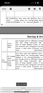

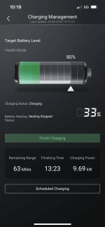

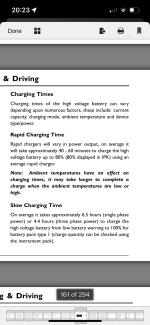

Looking at your screen shots you’re correct it does state 3phase charging is possible maybe I’ve been sold a pup.
Screen shot of Uk spec sheet that I have
But you know what this is going down the same vein as the other MG cars you see when the face lifted 5 first came out Pat in France of pats tech & wheels he did some testing on it for us and a podcast a few times and he said his car in France came with the 11kw charger but Miles Robert’s was certain the the UK would not have that and he like me would have seen the specs sheets for the UK version and he was quite right it says single phase 7kw which is in fact 6.6kw so why did I say the same vein well my wife’s MG4 SE should not have the tinted windows but it does in the first batch of MG4 the SE had the wrong glass fitted and there where a few other things also that was not right San me with the ZS models they where not quite not what the spec sheets said so you are very probably right about your car

Well I checked my car out with a 3 phase cable and lo and behold your dead right and I stand corrected but I as I said earlier somewhere I’m always open to learning I am.
