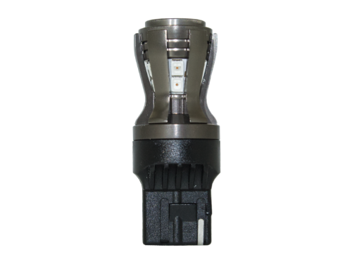

Are these the correct fitment?…
…wondering if they would be better. Seems to suggest that the light has a better spread than normal led.
