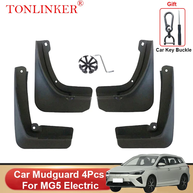

Fitted some Mud flaps from AliExpress yesterday & doing our first long drive in our new(ish) MG5 today, where there are reports of a lot of rain expected on route. I bit fiddly to fit at first but very pleased once I worked out to replace the existing bolt with a new screw, which are a nice black Japan quality. Came with stickers of MG rather than printed on which was a bit disappointing but in the end we didn’t put them on as wasn’t sure about the look.
£17.55 inc postage from here
TONLINKER Car Mudguard For MG5 Electric MG 5 EV 2022 2023 Mudguards Splash Guards Fender Mudflaps Accessories
They should help protect the paintwork from splash damage.
Not only that they make the car look so much better, especially looking at the back of the car.
Fitted the same ones to my pre-FL about 6 months ago and they really help to reduce the amount of mud etc. down the sides of the car, stops most stones & tar from hitting the paintwork and they enhance the look of the car too.
Good choice.
ps, didn't apply the stickers either.
