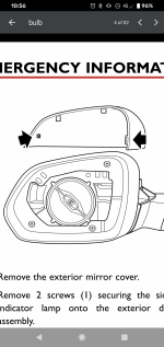

Firstly push the mirrors at the bottom until they face down as far as they will go (alternatively you can tilt them up and remove from the bottom but I found this harder and it felt like I'd break the mirror)
Put your fingers behind the mirror at the top and GENTLY pull until it pops off its holder.
You don't need to disconnect the wiring for the mirror you can let it hang.
If you use a torch you'll see the mirror cover is held on with two retaining clips which you can free with a flat screwdriver.
I found it easier to remove the 3 Philips screws and then disconnect the black plastic trim that holds it all together.
Be warned you may very well break at least one of the retaining clips - I broke one on each side, but the mirror still goes back together tightly without being loose.
Once it's all back together I tested the heated mirrors and also the blindspot warning (Exclusive only) to make sure the wires weren't damaged.
Removing the three screws and the black frame makes it much easier to access the tabs for the mirror covers:
