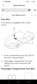

Does anyone know where the fuse box is located inside for connecting a dash cam
Went on a huge search yesterday and couldn’t find it. Removed both panels underneath the glove box and steering wheel and it’s not there.
I know sometimes you take the side panel off with the door open but it’s small and i could t see how to do it. I think I may have to ask a local dealer unless anyone her knows

You'll have to remove panels to get to it. MG don't make it easy!
It will be the same generic arrangement found on my car (MG5):
the flitch panel sounds a possibility as i have remove centre panel console and it’s not there and the gap on the cyberster door panel is very small. Thanks everyone still looking!
