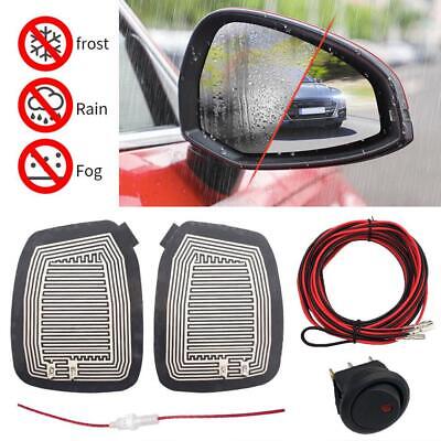

Not sure if this helps.
Could this kit be adapted in some way to fit on your car ?.
It would be a cheap fix if it would ?.
