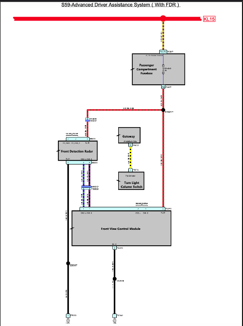

Hi @playako
Almost certainly yes, but in all the diagrams I have seen, none of them take ground from the fuse box, they take it from a nearby connector
What type of car do you have? Does it have a front RADAR?
It's a MG HS PHEV by front radar do you mean front parking sensors , 360-degree camera and Forward Collision Warning. Yes .
Thanks for the diagram
I'll check this out.
