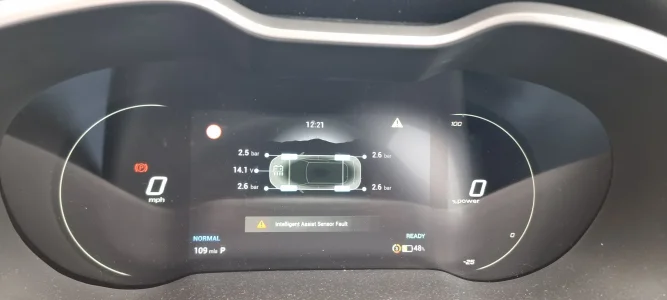

Has anyone had recent experience of this fault message and can advise on the best way forward. It appeared on my 23 plate ZS EV LR Trophy yesterday and beeped at me throughout my 100 mile journey. I've tried the 12V battery disconnect but with no joy and I've just contacted my local dealer who can give me a "diagnostic" appointment in 11 days time - at a cost of £252!!!!!!!! If it proves to be a warranty issue this fee will be waived. The car drives OK but I am also getting a warning message about the emergency brake system fault too. Both the front radar and camera are clean.

contact another dealer for repairs under warranty. if you post the photos of the messages you get, might be easier to understand; also, not sure what settings you have for "intelligent assist", try turning them off, see what happens?

As suggested, I attach photos of the fault message and of another message which appeared when I selected reverse to exit my drive this morning. Not quite sure why I get a message about the front radar when selecting reverse?

Just to close this one down. Managed to get a diagnostic appointment today after nearly 2 week wait. They checked both the radar and front camera, both OK, then found an overheating/stuck relay which they fortunately had in stock so it was replaced under the warranty and all seems well now.
