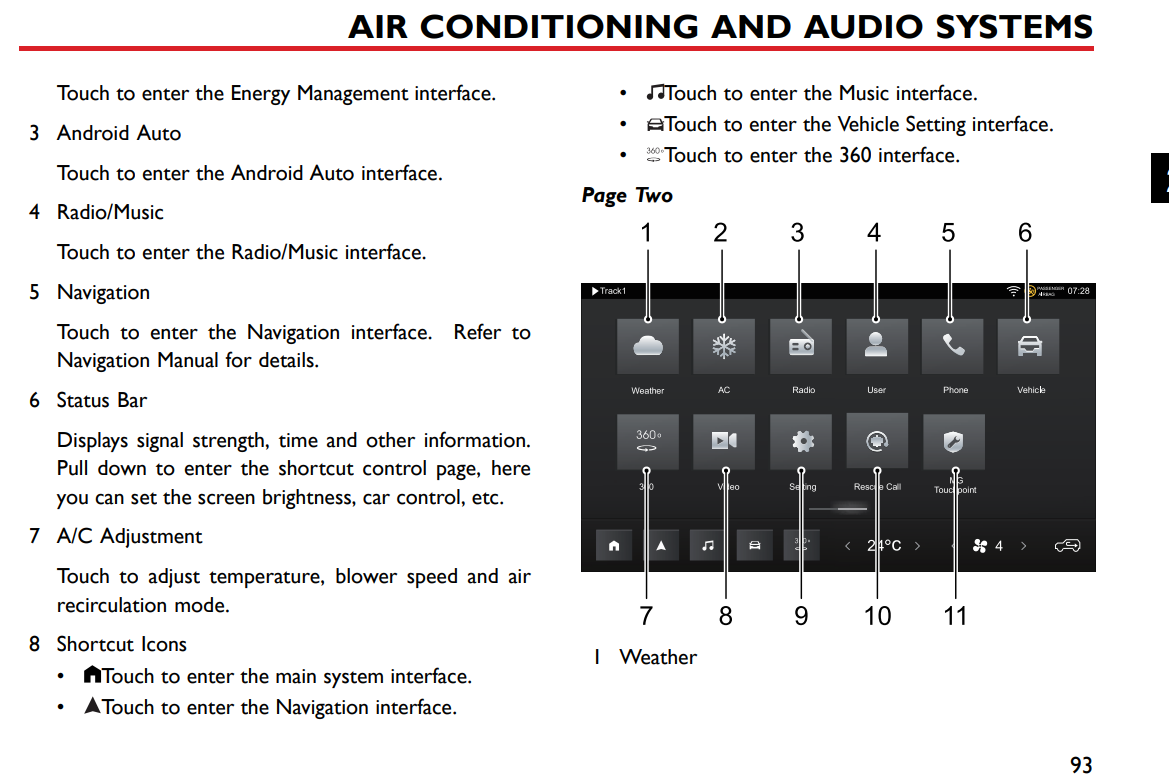

You probably have "connect" version car with live updates? Go into weather settings (No. 1 in the screenshot below) and see if you can switch it off... can't help much as mine is a poor-guy's version of ZS without live updates ...?

I do indeed have the LR Trophy Connect, and you were spot on with the place to look for a setting.
Job done, no more Moira!
Many thanks for your help

all , if you go into WEATHER SETTINGS, broadcast, option , move slider to off
Regards,
Glenn
