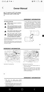

It is ok to jumpstart the MG4 from another car, but what must never happen is the other way to other car than an EV.
In other words, never jumpstart an ICE car from an EV as the EV startbattery is to smal and you risk to kill your EVs battery charger (very very expensive). I think this is highlited somewhere in the manual.
The jumpstart procedure is found in page 263-264 in the manual.
P.s. No need to have the ICE car running when jumpstarting an ev and be sure to remove the jumpstarting cables as son the MG4 is in ready state.
