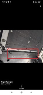

Hy guys, today I had to switch my summer tires with the winter ones, so I asked to guy to lift up my car on the elevator. Well, the surprise was waiting to be seen. The shield is not looking too good, there is missing one screw and the shield itself has a strange shape (it looks like it was bigger than it supposed to be and because of that it made a round bump) see picture. Any idea how could I solve this issue and from where I could get the parts? Thanks

The screw is missing, that's all I can tell you. I heard is a know problem but no recalls. I don't know how that spare part would be called in English or from where to get it. I don't even bother with MG.

That photo shows that the rear undertray "fix" (bracing piece) has already been fitted - simply that the bolts either weren't properly torqued, or that they used the original bolts rather than the longer ones that are needed with the brace piece. (I'm assuming that it's the bolt at the right side in the picture that is missing - the photo is a bit too small for me to be certain).

The undertray "fix" is not on my car unfortunately that's why this problem occured. In the second picture I've shown you how it can be fixed but I don't know how that fixing part is called like, in order to purchase it and have it installed by myself
