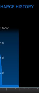

At the end of every full charge my ZS takes at least a 4 hour balancing charge at 0.3kW. Sometimes 6 hours.
This is in addition to the very poor fast charging and very low battery capacity compared to specification.
Max charge rate ever has been 36kW. Spec 76kW.
Max charge from zero to full 32kWh. Spec 44.5kWh.
MG will not accept that there is a problem because diagnostic says battery is in good health. PS last time we used DC charging was 2 months ago and before that 6 months and car is used daily.
Does anyone else have the balancing problem?
