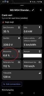

I did that last saturday. I went to 1.5% SOC and then charged at 6.5kW. The Wallbox said i charged 53.08 kWh. Assuming a 8% losses and the initial 1.5% SOC, a full charged battery is 49.57kWh, a 97.6% from the original 50.8kWh.
The car is almost two years old and 38,000 km.
The car is almost two years old and 38,000 kms.
So kinda difficult to have a ~42kWh usable battery pack, as T1 claims. Unless MG has Renault ZOE sort of charging losses :D

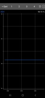

Sorry i not belive in percentage displayed by BMS after what i seen happens when battery calibration done on pack with huge imbalance.
If you use Car Scanner loock on high and low voltages of cells when you discharging lower then 10%, highly likely when you reach 0% you will see high delta but still high voltage (3.18 - 2,9V) on higest voltage cel and weak cell will be across 2.7-2.5Vl, in your case one or more cells not charged fully and after calibration pack lost 16%
I attached screenshoots of my pack discharged 3 months ago (sorry not MG4 but also LFP pack)
Highest cell have voltage 2.946 volt (not 0% discharge ) and 2 undercharged cells with lowes at 2.4 volt dictates nominal capacity of all pack less then it may hold because afterward BMS counted less ah charged back till first cell reached 3.75 volt and started display 1%= 1.46 ah, now loock at second screenshoot after 3 months at 94.2% BMS displays used 13 ah that way more then factory capasity per 1% (1,53 ah in my case) becaus now my pack balanced better, loock on third screenshoot
To do a numeric example: let's say my worst cells are 10% out. That means they need to catch up 15Ah (150Ah cell capacity). At 200mA that would take 75 hours of balancing to get the low cells back up. Long, but feasible.
I'd still prefer it if my pack balances a lot earlier, when the lowest cell is just 1% below the highest or even less. Thanks to the steep voltage gradient that is very easy to see near 100%.
Yes that take in my case month to balance with passive balancers to reach delta 117-120 mV at moment when charging stops (before i balanced pack i seen also 360 mV), but think delta can be lower
My pack almost 2 years had high delta and i reach point of 93% SOH and recovered 3% by discharging pack to 2.0 v on lowest cell (BYD) and charging back to 100% slowly.
After i realised that balancing happens only when car active i understand that i screwed my battery by not letting car work enough hours bethwen charging sessions to do balancing , in my case at least when delta is high the balancers do their job better when battery discharges then when battery charges, in addition to that i used to frequently charge battery from 98-90% with 11 kW charger dayly stupidly think that after reaching 100% BMS balancing cell when car powered off.
Curently my pack have nominal 146.88 ah out of 153 ah of factory capacity.

From what I've experienced in the past, that fully discharged graph is telling you that you have either a high resistance connection or internal cell resistance, or you have a cell that has lost a lot more capacity than the others.
You can only top balance - at the end of charging, or bottom balance, at the end of discharging, you can't have both.
If the pack in top balanced, don't go down to 0% SOC cell voltage is more important, an absolute min. of 2.8v under load.
If the pack is bottom balanced, charging must stop when the highest cell voltage reaches 3.65v .... you can go as far as 3.85v if you are planning to use the pack immediately, but don't store it for any more than a few hrs at that peak voltage, you will cause the internal voltage in the cell to climb due to the internal heat generated causing the electrolyte to break down.
If a battery pack is bottom balanced, top balancing must be turned off, otherwise the bottom balancing will be affected creating a battery pack that isn't balanced at either end .....
