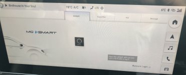

I had no QR codes showing on the Ismart area, this is how I got it working and getting the car out of Transport mode to consumer mode :-
1. goto settings and select system
2. click on 'Entertainment System Version' 5 times
3. then enter the code 200519
4. then click on Activate
5. Then click on 'Switch Environment / Current: until it is a single P
Then back out and go check ISmart and your QR codes will now show up.
In step 5. above mine was set on PP after picking it up from the showroom, this is the transport mode and P is the consumer mode....obviously got forgotten to be changed over during PDI

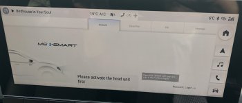

My system has worked fine since collection
But this morning touching weather or settings gives this activate head unit first message
Phone still connects and functions work
But can’t access anything in the car itself
Before starting to diagnose just wondered if it’s a general server issue and if any others have same issue

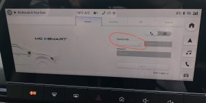

If I try to log in on head unit get message device id does not exist

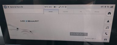

The solution is to connect the internet in the settings of the car, select wireless, then choose your WiFi and appropriate password.
next use the home button and settings again at the bottom of the screen is activate.. press this. Can’t show that choice as mine has now re connected.. hope this helps, regards Phil c
