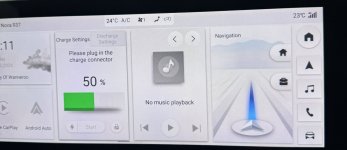

Second post for today, busy troubleshooting various tech issues on my new Aus MG4 Essence;
MG music app not connecting- sometimes…
Driving along, pressed Music app button, only options were:
1. BT Music
2. Online Music and
3. USB Music
All radio stations are programmed including digital. Normally I’d see the channel options and the car would auto play last channel when turning Music app on.
Today, nothing.
On the driver dash display screen, it’s also ‘blank’, just the music note symbol.
Turned on, off, pressed all the buttons, in out on off, etc. still nothing.
Then… it did connect to digital radio, last station. It showed the station on the main display, but did not show the radio was on on the driver display screen, still ‘blank’ with music note.
Anyone had this issue, is it the car, or me? Photos attached for info.

I have a Trophy somaybe different. When you say the Music App button do you me the panel on the home display. Did you cycle through the options (radio/BT music/Online music/USBmusic) using the top < > symbols on that panel? If you touch the panel when it is in music mode it will display a page with only the music tabs and not radio.
In the UK I sometimes lose my favourite channel and there is no sound. As regards the driver's display, did you try toggling left/right ircancelling the music display to refresh the screen?

I occasionally start up and the radio stations are not displayed and unavailable,
But if I go to FM it usually works and also wakes it up! I then go back to DAB and it’s all there again.
