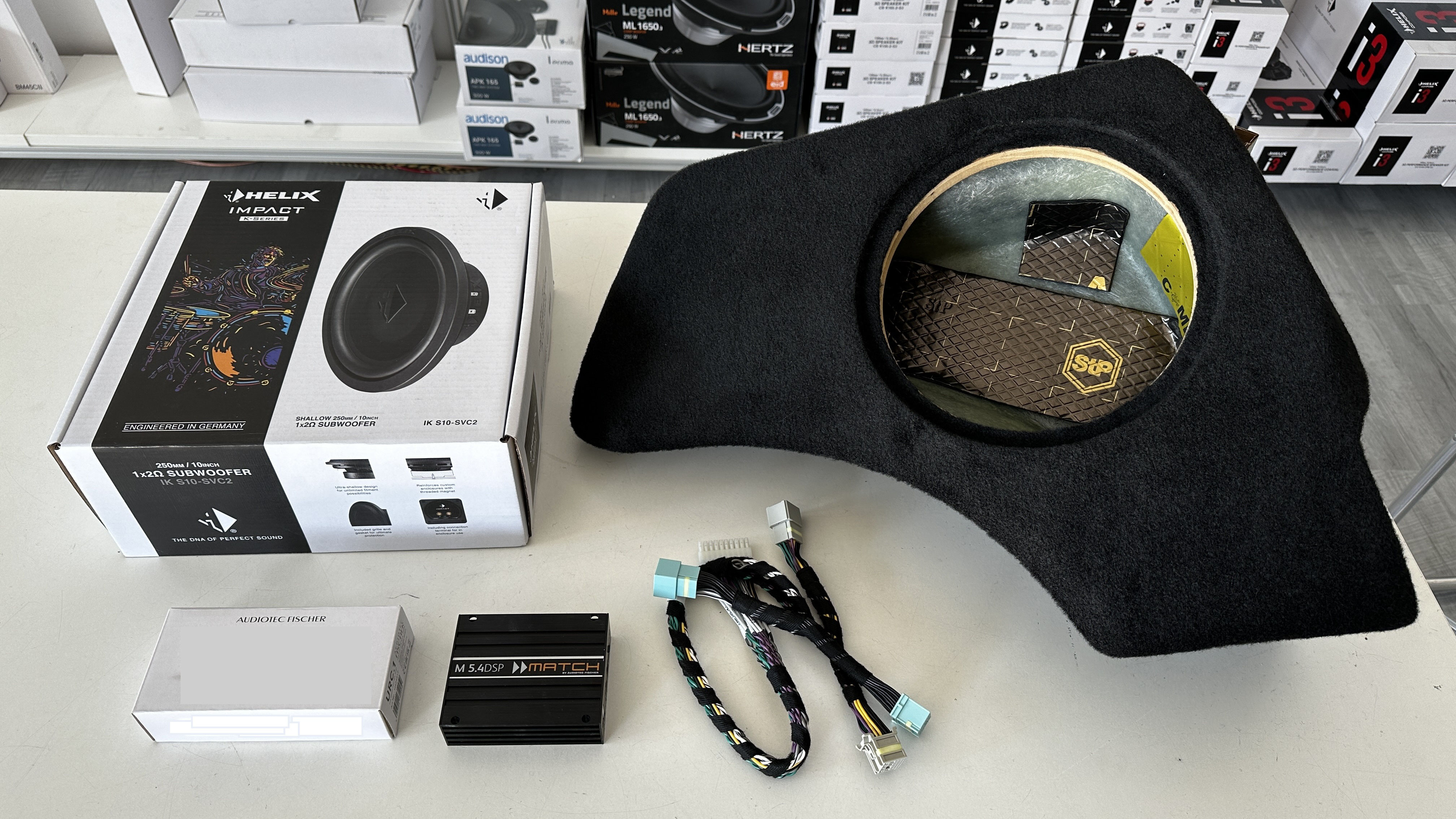

So I found these two products online and I just wanted to ask if anyone has experience with these.
Bose Tweeters: Saic Bose Tweeter for MG
Plug and Play Trunk Subwoofer (That fits absolutly perfect)
If this works as easy as its seems to me than that would be a great upgrade that doesn‘t require a lot of rewiring and other adjustments. Shure, you pay a premium for the sub but the perfect fit and ease of installation would be worth it for some people I think.

Had a quick look on their website, and they say its simple to fit. Just Plug and play. No cutting, crimping, soldering etc. But just says MG4 nowt else. No particular models. Probably best to get In touch with them. Make absolutely sure it's right for your model. As it certainly ain't cheap. 🙂👍

I received an answer:
1) The upgrade by Speaker City is for both speaker configurations (4 and 6 speakers). If you don't have speakers in the rear it´s not an issue - It will just stay silent.
2) Speaker City is a one man company/shop and it's run by a German guy (who also is incredibly nice) and therefore the sub is not a standalone branded product - The housing is specifically designed for the Mg4 and the setup uses the Helix IK S10 with the Match M5.4 DS (pre programmed).
