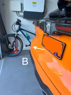

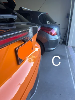

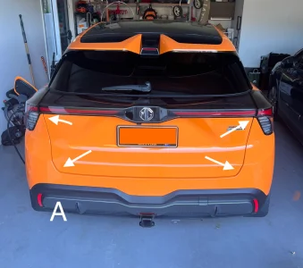

Ok, so here’s some more pics with rather amateur-ish arrows added.
Zoom in to see the differences at the arrow points.
A. Show the small differences at various points around the edge.
B. + C. Show the more obvious differences when viewed from the side.
Some of the noise comes from the rattling number plate. If you hold it as you close the tailgate it’s reduced. but not completely. My thought is there could be some ‘stuff’, loose and flapping inside the tailgate. Maybe part of the wiper mechanism. I’m guessing really. Putting some extra rubber cushioning at various points is on my ‘to do list’.

No problem, more pics if you want.
My old dealership at Noosa had got conformation from MG that the work could go ahead under warranty subject to a reasonable quote from a local body shop. And then Noosa MG closed and the paperwork/case was transferred to Gympie.
Which is where the project stalled.
There’s some bolts that needed to be removed which would have probably resulted in some paint repair work. I’m concerned the paint won’t match or at least will look different in 3 or 4 years time.
As for the noise, it’s just the same as my 14 year old Peugeot’s tailgate. It’s not rattling while driving. It’s just a clunk on closing. Guess I was expecting something better from a brand new car. For at least a few years or until the rubbers have deteriorated in the heat and humidity.
I’m sure I can improve it, I just need to schedule it in for some tinker time 👍
