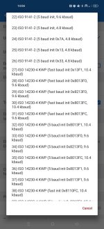

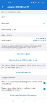

Do you know which protocol car scanner is using to communicate with the ECU? Also are you using Bluetooth, or Bluetooth LE? The app should say somewhere, hopefully.
Those settings seem identical to mine!
From the first screen you show, if you click on "Advanced Settings", what is shown under "ECU Protocol". Mine says "0) Automatic by ELM327". All the options you show in your second screenshot are what I see if I click on that "0) Automatic..." line but I've never needed to select anything different there.
Which version of Car Scanner Pro do you have? Settings>Info shows mine as 1.104.0, build 401040.

My app version is the same as yours.
Some BMWs have issues with the auto ECU protocol selection, which can be fixed by selecting it manually. It may not help, but I thought it was worth a go.
The Nexlink user manual says the Bluetooth protocol used can matter too, but it seems like that isn't the issue either.
