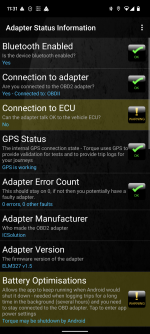

Same issues. Tried three now and sits at this, not sure what's up. Does anyone know the exact protocol is using as even though I'm choosing thorough scan maybe selecting the correct one might help.
