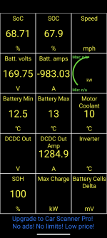

Pleased to report car scanner ( free version) and my old Konnwei OBDII dongle i usd with the 2018 Kia Soul work together, no fuss.
Confirming that my 'new' MG4 that had been sitting in docks somewhere for 10 months hasn't suffered battery degradation. Good starting point ??
