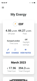

Just had an email in:
Don't forget to adjust your charging schedule
Clocks are going forward on Sunday 26 March and daylight saving time begins – longer and lighter evenings at last!
Old off-peak time: 12am to 5am,
New off-peak time: 1am to 6am
I assume that I leave the Ohme "charger" to do its own thing?
