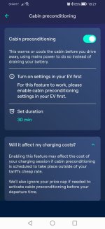

I have an Ohme home charger and it has a function to pre heat the car but when I try to use it, it tells me to set it up in the car first.
Does the ZS have this function?

You can manually pre heat / cool the car from the ismart app on your phone, by using the two buttons on the R/H side of the screen.
Either A/C blowing or front window.
There is a HVAC tab where you can select the temperature you require in the cabin.

I've posted details here but notice on this thread you have an Ohme charger but a different set of buttons on the MG App. I don't see front window and only see Lock/Unlock on the front screen of my Android App.... is that an IOS only thing or am I doing something wrong please?
Main aim is to be able to manually turn on A/C whilst plugged into the charger and preferably drawing power from the charger but getting it working at all would be a bonus :)

Hi @fred12345 I have managed to get it running when it is not plugged in.
Screenshots below and hopefully this is just user error ? It doesn't change options if I go to the old skin for the app.
I'm on version 2.0.5 last updated August 7th and there's no indication of an update being available ?
Mine is the same version as yours but my car is the ZS, yours is a MG4. Could that be the reason why it is a different layout?
