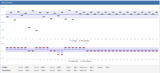

One thing that does concern me slightly, and I'm not sure if it's a OVMS mispoll or if I have a weak cell.
Another thing does anyone know what a sensible 12V shutdown value would be to avoid killing the 12V I set it to 11.4, but that might already be too low.
Edit: Will do a balancing charge soon and see what it looks like after that, could just be it's not had one for a while.
A 61kWh battery is as far as I’m aware built using a 96s1p configuration, your screengrab shows only 42cells, I assume there is more?
26mV difference isn’t concerning especially if balancing hasn’t been done in a while. Would be interesting to see how the balancing looks at low SoC (<10%).
As for the 12V aux, I would keep it in the green (around 12V) to avoid premature degradation.
Yep not sure if the cell monitor is setup correctly for the 5, soc seems accurate, I set module sleep for 12V.
Also the WiFi and cellular shut off has been set to 1 and 3 days anyway to avoid excessive 12V drain.
