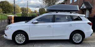

I have menabo brio roof bars (£38 eBay) on my long range with a Halfords 420 l roof box (£240)
Hope this helps
Ian

Thanks a lot, v helpful. Do you know how much your roof box weighs? And curious how much weight you can get on your roof. Love the white colour BTW. I have the blue colour

Roof box weight 14kg
Menabo brio roof bars 3.04kg
Hope this helps
I was torn between the blue silver and white for colour choice
But white was the only colour my dealer had in stock otherwise I would have been waiting 8 weeks for next delivery
Ian
