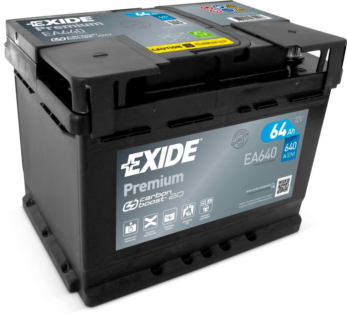

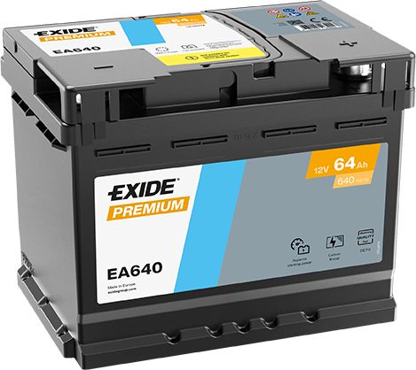

After a couple of times recently when attempting to start the car showed the ‘HV Battery Shutdown message’ I noticed the 12V battery was showing about 11.8V. I popped my booster pack on and it started instantly - once started, the dash showed 14.6V for the battery. So, I suspect my 12V battery is dying after almost 3 years - also looks a little moist on top, but maybe the last service added protective spray?
Anyway - although tempted by a top end Yuasa or Bosch, I opted for this Exide Premium. Seemed like a decent capacity for the price (64Ah vs 55Ah for OEM), CCA isn’t really relevant (640A vs 530A OEM) on an EV. Registration search seems to suggest an AGM battery but opted for a standard version.

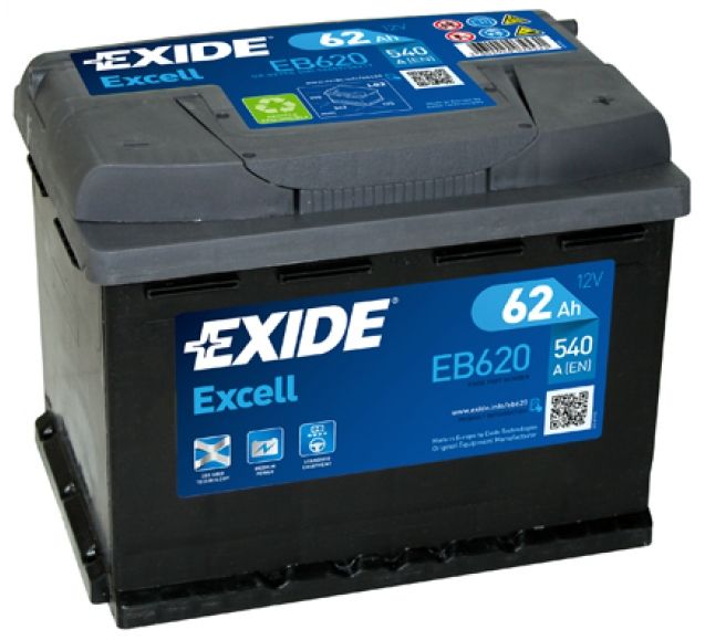

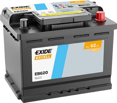

Anyway - although tempted by a top end Yuasa or Bosch, I opted for this Exide. Seemed like the best capacity for the price (62Ah vs 55Ah for OEM), the CCA isn’t huge (550A vs 530A OEM) but not a worry on an EV. Registration search seems to suggest an AGM battery but opted for a standard version.

I debated an AGM but figured that since there is no cranking current, then stop/start features isn’t an issue for an EV so no real discharges like an ICE or hybrid has. Even regen which is mentioned on some data sheets is all handled by the HV battery.
This is just the charging voltage so tells you nothing about the battery.
Edit : ah, the 14.6V reading. Yep - only mentioned that to show that charge was happening once I used boost pack to start the car - so more likely battery issues than a dc-dc inverter problem. It’s the sub 12V reading when HV battery disconnected that will be the battery voltage. I should carry my multimeter to check in case it happens again.
