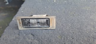

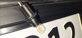

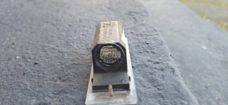

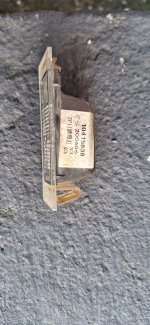

You can reach the lampholder by lay down on the ground, take your arm under the rear bumper, and feel your way to the lampholder. Then squize the leap at one side off the lampholder and push it down.
Just lie on ground and insert screwdriver into one side of holder and pry down. It will drop and pull out of holder as other side is held in.
Done the 2 in 2 minutes.
