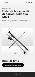

Italian MG website actually “sell” them. They are not available at the moment and you have to place an order

well done @jpk (y) (y) (y) (y) - if the car is upto 2000kg, then the roof with withstand 50-100kg easily, no way is MG trying to say that if you roll the car will it not hold up? - ps do you have an item code?
