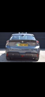

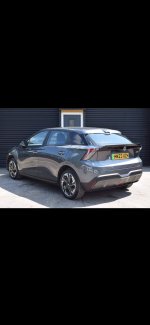

Hi yes it does I think? On auto trader it says it has rear wipers. I'm not sure if that's true or not. is there a way to know?

That's a Phase 1 car then, with an early 2023 registration. As such it may have been susceptible to the oil leak, and they're resolving that issue. Nothing to worry about as long as it gets fixed. :)

Your car looks like it is the same as ours and we haven't had any leak issues. Sounds like MG are sorting it so you should be fine.
I was worried about not having a back wiper but it hasn't been an issue at all.
I think you've made a good choice - grey is the best colour!
