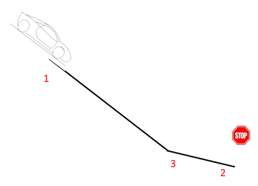

Hello,
I am making a quick call to get your feedback on my use case.
Every morning, I leave home (1) and activate the one-pedal (UC with OP only). On the downhill road (not depending charge level), my MG4 regenerates strongly in this phase with peaks to -25.
The deceleration is not sufficient to stop before the panel, on the false flat going down I apply a little brake. (2)
I hear rubbing noises from the brakes, my car stops, I release the brake and then the vehicle reverses. (between 50cm and 2m depending on the case, every time, I reproduce the problem on this road).
Using the OP continuously since September and taking this street almost every day, I became aware of this phenomenon following an module update in January.
The MG dealer noticed the problem and told me that he reproduced it with a vehicle without the shift, and that it is really linked to the profile of the road. He has no solution and makes me understand that it is incidental.
Can anyone tell me which modules support OP and regeneration? And share any feedback about this issue?
Thanks
