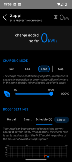

Yes I can post shot if Zappi setting, Zappi helpline checked remotely and confirmed all set up correctly. I believe the error lies with the car as it says EV preventing charging

I have a Zappi too. Your screenshot of your Zappi settings appears to show that you have scheduled selected but no schedule set. I don't have a charging schedule set in the car or iSmart app only on the Zappi app.
Tap the + inside the circle to set the charging schedule.

Thanks for taking a look. The Zappi engineer checked and said all looked fine on the settings.
I had a very short schedule set on that screen shot from yesterday so I could test with the engineer whether or not it started charging. The grey clock indicates I believe the schedule is set then when the start time is reached this clock changes colour to blue.
