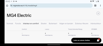

Mine definitely has a heat pump. Attached is the configurator page from the Dutch mg website
