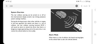

For clarification - I attach the manual refering to this system. The manual does not state that only rear lights flash - I guess all of them will flash, they work just as pressing the emergency button.
If this functionality is causing inconvenience - please check if RCW can be turned off permanently from the menu.
