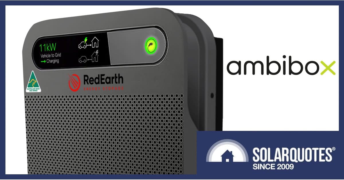

I came across this in my research:
As it happens, their manufacturing facility at Darra is not far from where I live, and I grew up in that suburb. I have no affiliation with them.
The article mentions "There’s no official word on price, but these solutions are rumoured to be much cheaper than first-generation bi-directional chargers that were around the $10k mark installed." That would be AU$10k for first-gen bidirectional chargers, roughly £5k.
Bidirectionality isn't a huge deal; my solar inverters (4 kW) were around AU$1000 (though that's nearly 10 years ago), and they have a bidirectional DC-DC converter in them. Unfortunately the battery end of those is 48 V nominal, so not suitable for V2G. But the same principle could be adapted to higher voltage.
