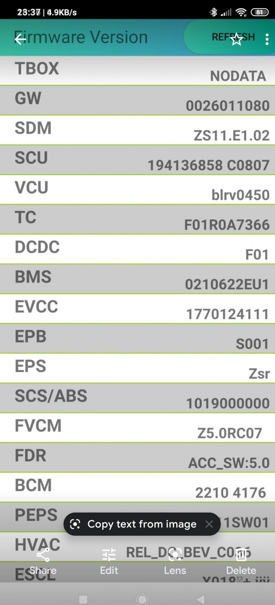

Hi could someone advise how to see the voltage reading after charging, so I can see if I need the latest BMS update? Thanks
Read page 20 in the MG ZS EV user manual supplied with your car.
You can view the screen as below.
However the only way, to check the BMS version, apart from asking the dealer, is to connect your phone via Bluetooth to the OBD2 port and read the data it should be BMS 0210622EU1 which is the latest version.
