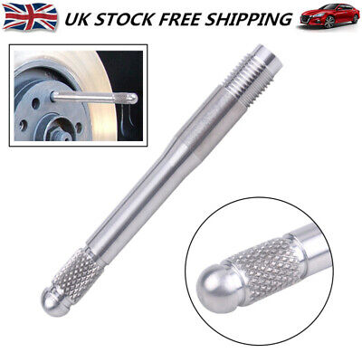

Just any idea, rather than using a conversion kit, why not consider using a location stud tool ?.
VW supply one of these tools in their spare wheel as standard.
It is a huge help when trying to lift heavy wheels onto hubs that don't have any studs on the hub.
Just thread this stud into one of the hub bolt holes ( at the top ) then hang the wheel off this stud.
Let the wheel swivel on the single stud, then it is simple to align the holes in the wheel and the hub.
Once you have a few of the bolts started, then unscrew the stud and install the final wheel bolt.
They are available in M14 X 1.5 and 1.25 from EBay for about £8.00 ( ish ).
Looks a bit like this !.

Quick update on the spare wheel stud that I sent for.
It arrived this morning and I have removed one of the road wheel bolts and checked it back to back against the stud I purchased.
Yep - My theory was correct, VW and MG are using M14 X 1.5 thread pitch.
The stud is a nice fit into the hub, when one of the bolts is removed.
I would strongly recommend getting one of these studs to aid changing of your wheel !.

If you intend to knock one up on the lathe, then worth a note.
If you take a look at the stud I purchased, it has a slight tapered section.
This helps align the road wheel and makes locating it, a lot easier than having just a parallel stud.

VAG ( VW etc ) have favoured wheel bolts over wheel studs for a long time.
A wheel fitted with bolts over studs, is a lot more difficult to align when the car is sat low to the ground.
Like when you are at the side of the road, with a puncture.
You only have the centre part of the hub to hang / support the weight of the road wheel until you can get one of the wheel bolts aligned / started.
In most cases, the wheel will keep falling off the hub centre all of the time, before you can get one of the bolts started ?.
This is why the stud comes in handy.
When you are ready to refit the wheel,
screw the stud into a bolt hole in the hub, at the closest 12 o’clock position.
Offer up the road wheel to the stud.
Now you have something to align / support and then take the weight of the road wheel.
Now you can align a couple of the wheel bolts with the hub, without struggling too much.
When you have a four of the bolts started, finally remove the stud and fit the final wheel bolt to the road wheel.
Done !.
