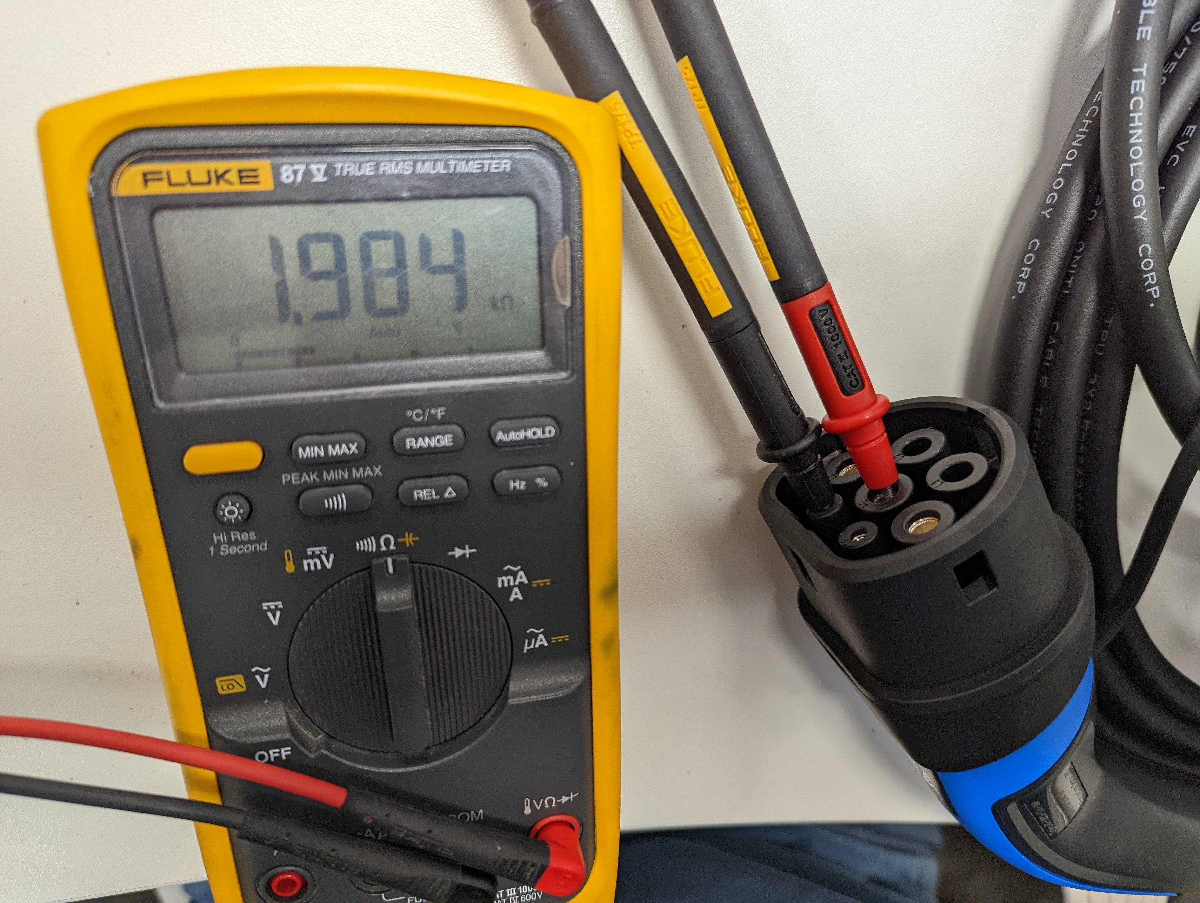

There are a lot of threads about playing with resistor between the PP and PE pins in the cable to adjust the power output. I believe people like EVCables used to supply cables with the higher outputs, but changed to the standard values a year or 2 ago - no idea if there were potential reliability problems or it was a liability issue.
This post looks like it's from someone at EVCables:
You can't search for V2L, PP, PE in this forum as the keywords are too short. You can get some results by doing a Google search:
site:mgevs.com pp pe
