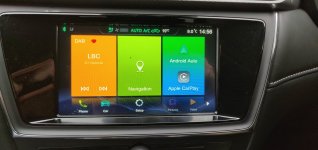

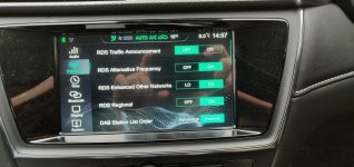

Regarding your DAM/FM radio issue. I have a MG5 but I assume it's similar.
Go to "Setup" on your home screen.
Click "RBS/DAB" in the left hand menu.
I think you need to turn off "RDS Alternate Frequency"
