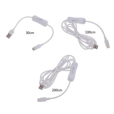

I bought the switched cable linked above. Arrived today but I can’t get it to work. Just noticed the ad on Amazon says not data?
As you were. My switch cable although advertised as power and data is probably not good quality as have had dropouts using switch. Still OK unplugging and plugging in adapter OK and no dropouts. Will return switch and try another one with better quality.
I’m going to return the one linked above as it’s definitely not data. Now ordered this one will report back if ok.
Update. Wireless carplay been working well with no dropouts using the switch off/on when starting journey. Car booked for updates 10th May so hopefully may be able to ditch the switch.
