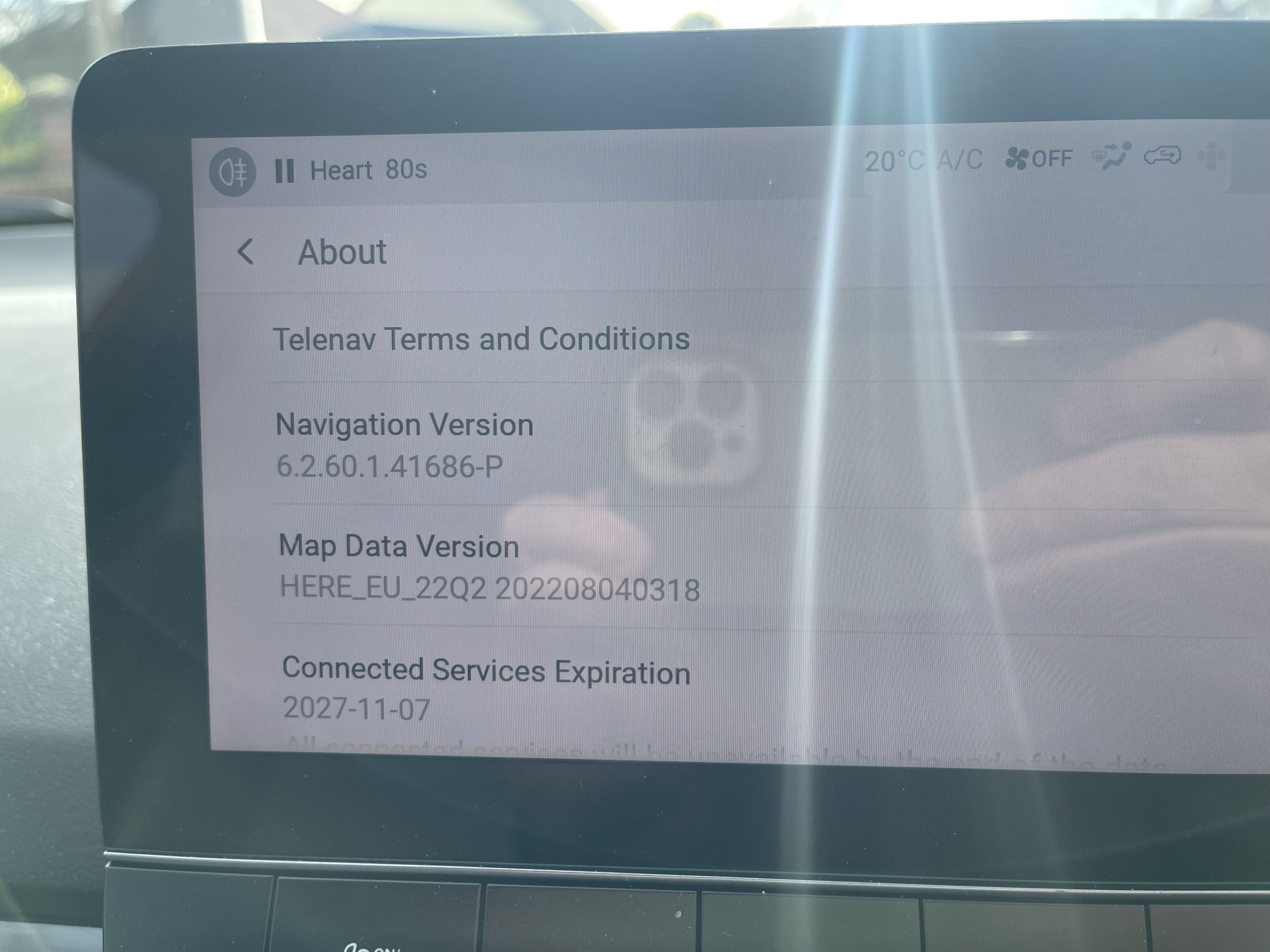

Anyone downloaded version 22Q2 202208040318 and run it successully?

I did the update to mine last week, and it appears to have worked fine. (I've had the car 2 weeks now)
I took general advice from this thread Tutorial for updating maps on ZS EV Gen 2 (avoiding mgmotor.eu)
Must admit I haven't actually used the satnav for routing yet, but it finds my location and follows the road ok when just viewing in the main screen.
The link in post #2 mentions Q1 2023, but the latest is actually Q2 2022 as shown on the users display screen.
The only issue I had was the amount of time it takes to uncompress the maps.zip file and copy the resulting maps folder to a USB drive. In all that part took about 2 hours!
The update took around 30 minutes, 5 minutes recognising the files on the USB and about 25 doing the actual update.
I only had 1 favourite saved (home address) which was preserved.... The TomTom built into my previous Renault Scenic would lose everything each time it got updated.
I did use the link in post #1 to get the updated map

Just tried to update my Trophy and failed. I used an admittedly very old 32gig USB stick but freshly formatted on my Mac to exFAT. The download on the EU MG site said 2023Q1. It took an hour to download the 19.84gigs of files onto my computer using a pretty fast internet connection. It took another two hours to transfer the files from Mac to the USB stick. Once in the car it took about 10 minutes for a dialogue box to appear that said "Select resource from USB". After another 10 minutes I got another dialogue box with three bullets:
  • Select map data from USB
  • No VR data from USB
  • No electronic manual from USB
A few minutes later a green tick appeared against the first bullet but after waiting another ten minutes no other ticks appeared so I selected OK.
Then "Getting Md5 info for all files" appeared
Then "Failed to verify the map files in md5 mode"
I'll try again at the weekend and use a brand new memory stick.
Have a look at your extracted files though. There is a version.txt file in the maps folder - what version is in there?
If you look at my post #6, when I did mine nearly 3 weeks ago it was quoted as being 23Q1 but the downloaded map was 22Q2
Just re-downloaded to check and its still 22Q2
