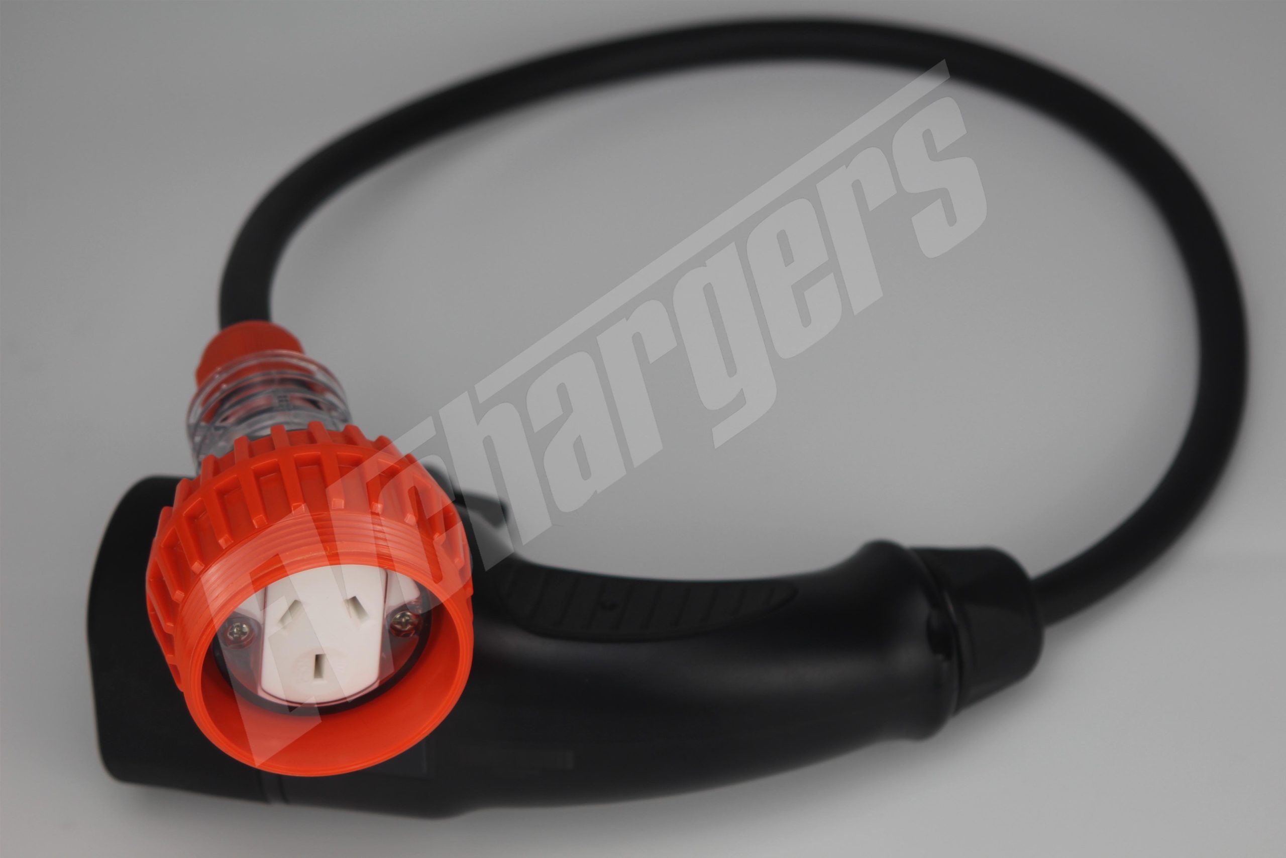

Hi, I'm looking for help with V2L on my ZS EV.
I have tried 2 different discharge connectors now both with no success. (see attached picture) it seems like the car is recognising it as a charge connector.
Has anyone else had this issue? Can anyone think of the cause? I have measured the resistance of my latest connector accross pins PP-PE and that measures 470ohms as it should be for a discharge connector on the MG.
I tried the cable first from evcables.co.uk then I tried the one from ebay mentionned in an earlier post. Both didn't work. Same issues

Is your ZS a MK1 or Facelift version? The Mk1 doesn't have V2L.
The official MG discharge cable has a 2000 Ohm resistor, it would be worth changing it in one of the cables you have to see if that works. the 2000 Ohm resistor limits output to about 2.2 kW.
Face-lift version, 23 reg only picked it up last month. I'll see if I can get a 2k ohm resistor and replace the 470 ohm resistor and see how that works. Thank you for the help
