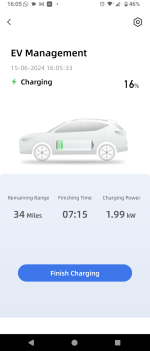

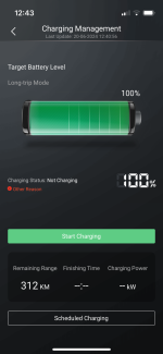

What is the MG app? I have the charger, and a smart power point so I can turn the point on and off with my phone. But I’d love an app to know when the car is fully charged, rather than going out and turning it on.
Hi Bronwen, not sure it will work with a hybrid. It’s pretty clunky and has connectivity issues if the car hasn’t been unlocked for a couple of days. It also went awol for a few days a little while back. Nobody in Oz could connect with their car! Once you get used to having it, it is problematic to lose it lol.

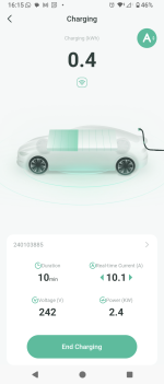

I guess this means my car does indeed balance. It actually reached 100% 20 minutes earlier and then drew ~4kW (min of the Wallbox) for some time.
4 kW (6 amps times three phases at 230 V) is the lowest maximum that the Wallbox can tell the car to stay below. But the car can draw any current less than this limit if that's all it needs.

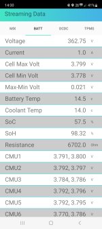

Just started using the eZS app and here is the battery data screen which shows a SoH of 98.32% and a cell imbalance of just 0.02 V across the cells
